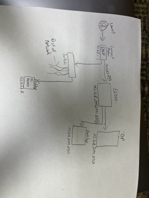

Its a Linksys E2500, i have it essential setup like this
comcast modem > e2500 > op
in the router ports 1 and 3 have the omni pro and a computer.
the router is a 10/100 but i cant confirm the duplex
Either I missed something (apologies if I did, it's late :)), you don't have a router isolating your OP.
Is your modem in bridge mode (meaning the WAN IP address is sitting on your Linksys)? It looks like you just switched out the Ubiquity router with the Linksys? If that's the case, I would put your Ubiquity back the way you had it, and plug your E2500's WAN port into the LAN side of the Ubiquity router. Then plug the OP into the LAN side of the E2500, and set up port forwarding on the E2500 to grant access to your OP to devices located on the WAN side of the E2500 (which is your LAN side of the Ubiquity). Your computer etc would be plugged in to the LAN side of the Ubiquity.
This will isolate all broadcast traffic from the OP. Of course, I've had E2500 series go bad on me as well, so that's another variable to keep in mind.
No more late night posting for me lol. I would move your desktop to 192.168.1.x network (at least for testing), in case that machine is generating traffic which may be causing this. So the WAN port of that Linksys has a 192.168.1.x address correct?
Yes the router has the 192.168.1.253 (Which used to be the OP ip address). And it's two computers in the drawing, one on each side. I removed the one thats in the same router as the panel to see if that will help when i was testing but i didn't see any difference.
We're planning to do some overhaul on our system in the coming weeks, but idk if thats going to change the main issue. I genuinely don't know what to do at this point.
The one thing i could say is we do have a list of automations setup on the panel, but i'm not sure what specifically what to look for. If any of you guys are free to maybe do a remote session or anything i would be down with whatever.
