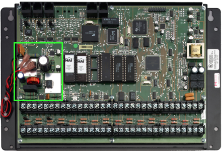

Out of curiosity, can you please take a high resolution photo of the area marked in this green rectangle (especially focus on the capacitors, the taller cylinder like objects)

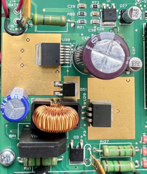

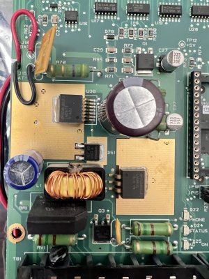

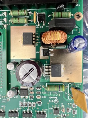

Electron as you requested here are three panels that I have. My latest situation is the reinstallation of the extra main panel allowed everything to come back up. I only have one fault showing and that is a fuse showing “trouble now” on the consul. The two fuses on the expansion panel Test OK. Any ideas on that one.? So far everything looks like it’s working. Getting ready to send in my failed panels for repair.

Yea not sure about the 'trouble now' error, I don't have any experience with the HAI OmniPro itself. It will be interesting to see if they're replacing those capacitors as part of the repair. The blue cap in the last pic looks a little bloated, but these caps can fail before looking like the typical bulging capacitor.

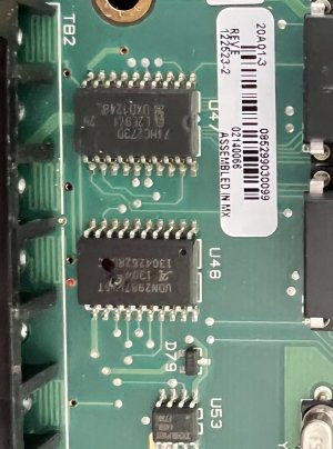

Electron of all the failures 4 I’ve had they all seem to be like this shown in this picture. After a lightning surge nearby😩

I burned up a new OmniPro 2 panel upon bench testing it and shifting the power wires over to the left one terminal by accident. I saw smoke and the area of the board pictured above was blackened. HAI at the time replaced it free of charge. I had another OP2 board older first generation which had the bulging large capacitor and leaking a bit. The board still worked fine but I replaced the cap anyhow.
