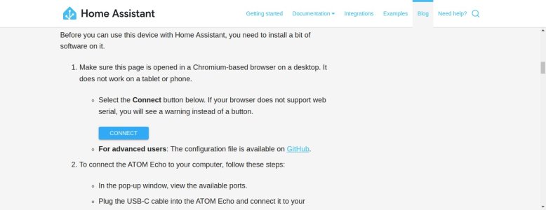

The easy part was programming the device with Chrome. (via Linux or Windows 11).
There is an order to do this and it is a bit different from what is documented. Will post here.

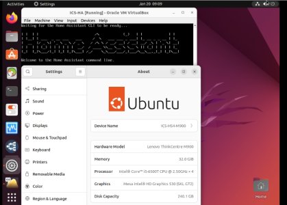

Note here running HA in a Virtual Box on an Intel CPU which make VR faster than running it on an RPi.
Two running here now. Its the VR part that I am concentrating on. There is a tiny speaker on the device which works.
The ATOM Echo Smart Speaker Development Kit device was easy to program on Chrome in Windows 11 and or Linux Ubuntu Chrome.

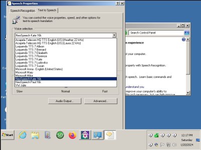

Homeseer 4 running on same box. Audio (and TTS) is a mixture of HS, Ubuntu, HA and one Alexa dot now using Russound in wall tiny speakers.
SAPI speech via multiple voice fonts and instances for HS2-3-4
on Oracle VirtualBox in Ubuntu 22.04 on Lenova M900 Tiny with 32Gb of Ram and SSD hard drive. The box is also running Homeseer 4 (latest version), CumulusMX and a Windows 7 32bit Virtualbox for 6 SAPI voice fonts.

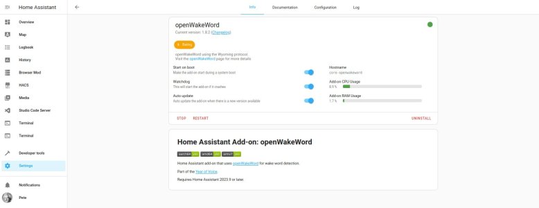

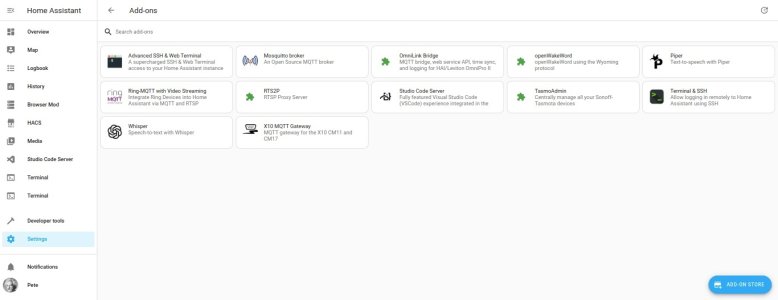

2 - Local Assist Pipeline - not using HA cloud here.

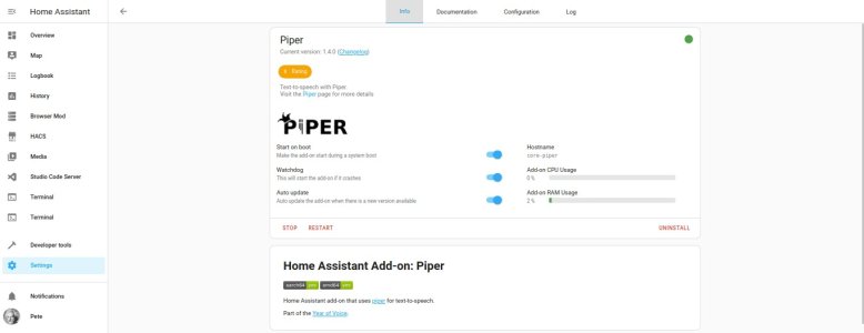

A - install Whisper -
B - install Piper
C - install OpenWakeWord

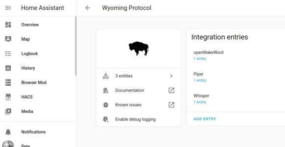

3 - Install ATOM Echo Smart Speaker Development Kit
USB cable from device to PC (any Windows or Linux running Chrome).

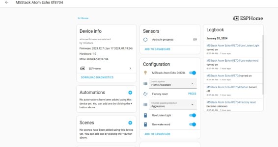

Note this is the second time I have installed ESPHome. It automagically installed when I installed the Atom Echo.

Neospeech and all of the SAPI voice fonts are for Homeseer speaker.exe running multiple time with different speech fonts connecting to Homeseer 2-3-4. I am using two VB instances of HS2 to run Homeseer Phone with two Way2Call boxes. Homeseer 3 cuz it runs great and Homeseer 4 because I am learning it still. My 15 tabletop tables all run Homeseer Touch, speaker.exe (with whatever voice font) and OmniTouch Pro (for alarm panel).

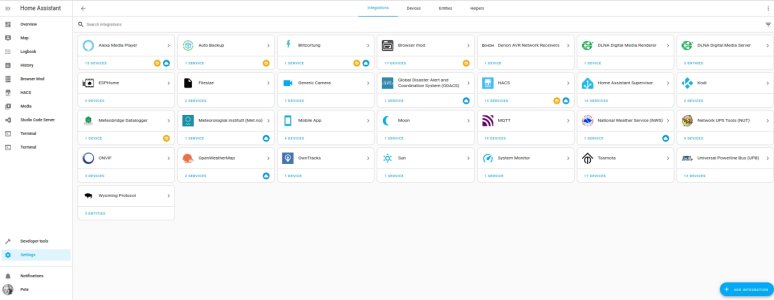

TTS from Home Assistant sounds great. VR is working fine and faster than the Amazon VR. Only thing when I enabled VR it enabled 280 VR controlled devices came up which I will be tweaking down. Will do a video of using one of the ATOM Echo Smart Speaker to turn on devices. Note this is a test configuration for a peer in Texas who went from a home with Gb internet to a home on 20 acres with DSL Internet that wants less dependencies on the Internet. He was using Google home devices in his old house.

First time connection to Atom is via a serial connection and Chrome running on Windows or Linux.
I have not documented that piece above.
A set up window opens up ...
1 - initially uploading new firmware to the Atom, then
2 - a set up window configuring the Wireless Access and
3 - finally the set up window to HA comes up where it automatically installs ESPHome and your Atom device.
Will redo set up and take a picture of each screen and post it above as one image with multiple pics on it.
1 - plug in the Atom to your PC with Chrome running.
2 - Go to this web site in Chrome
3 - click on connect

280 items came up to control here and disabled all of them then enabled just 2-3 to test and they work.
