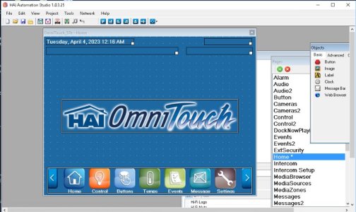

Concurrently here have used the Homeseer Touchscreen designer which works better for me than the HAI designer. I have yet to master using the HAI screen designer. (years now - cuz I never really change the OmniPro 2 configurations).
Noticed that the designer is using the controller file on start up so that is not in the template. I did remove the IP for my one testing camera. The design is very stripped down. I noticed when putting weather maps and colored icons et al in the Omnitouch 5.7e screen it slowed down to a crawl. The camera view is just a JPG per second capture...and is very slow.
I am running the HAI touchscreen designer application (32bit) on Windows 2016 64bit and accessing the server via RDP from my mostly Ubuntu Linux laptops / desktop here.

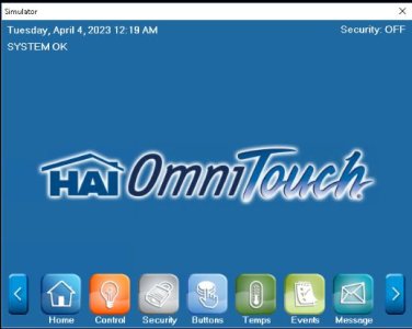

Screen looks like this:
The tabletop HAI screen designs have more screens, color, web pages et al...and much faster. Tabletops are using Intel Atom based CPUs running embedded Windows (of old).
To test this template do the following:
1 - use the PCA controller file as a base configuration for the designer.
2 - load up the template and run the simulator...easy button stuff.
BTW you can run the simulator and not upload the design to the Omnitouch 5.7e for a look see. It does take more than a minute to upload the new firmware to the screen (personally its minutes and very slow).
Base / stock Omnitouch 5.7e template is included in the examples directory.
