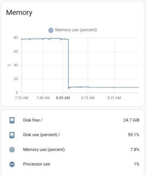

Noticed recently here that HA #2 Virtual Box running on Ubuntu 22.04 host kept running of memory and rebooting itself.
IE: would run up to 100% in less than an hour then reset itself. HA #1 running many add ons averages 8% utilization.

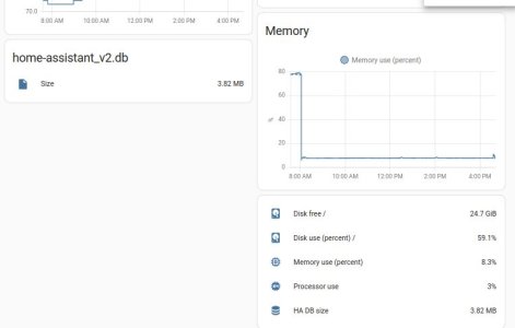

Database size was 2.5Gb. Deleted it and it went back to 2.5Gb in one day. Original build was 32Gb which was expanded to 64Gb.
Noticed that Blitzortung Lightning Detector add on was configured for entire US. Each lightning strike created one MQTT entity which filled up DB.
Reduced area to 5 miles.
Renamed file config==> .storage ==> homeassistant.exposed_entities to homeassistant.exposed_entities.old and restarted. (used sftp for this)
The homeassistant.exposed_entities file was 1.7 Gb. New file created is now 1.2kB and memory hovers around 7-8% which is similiar to HA box #1 with many addons running.
