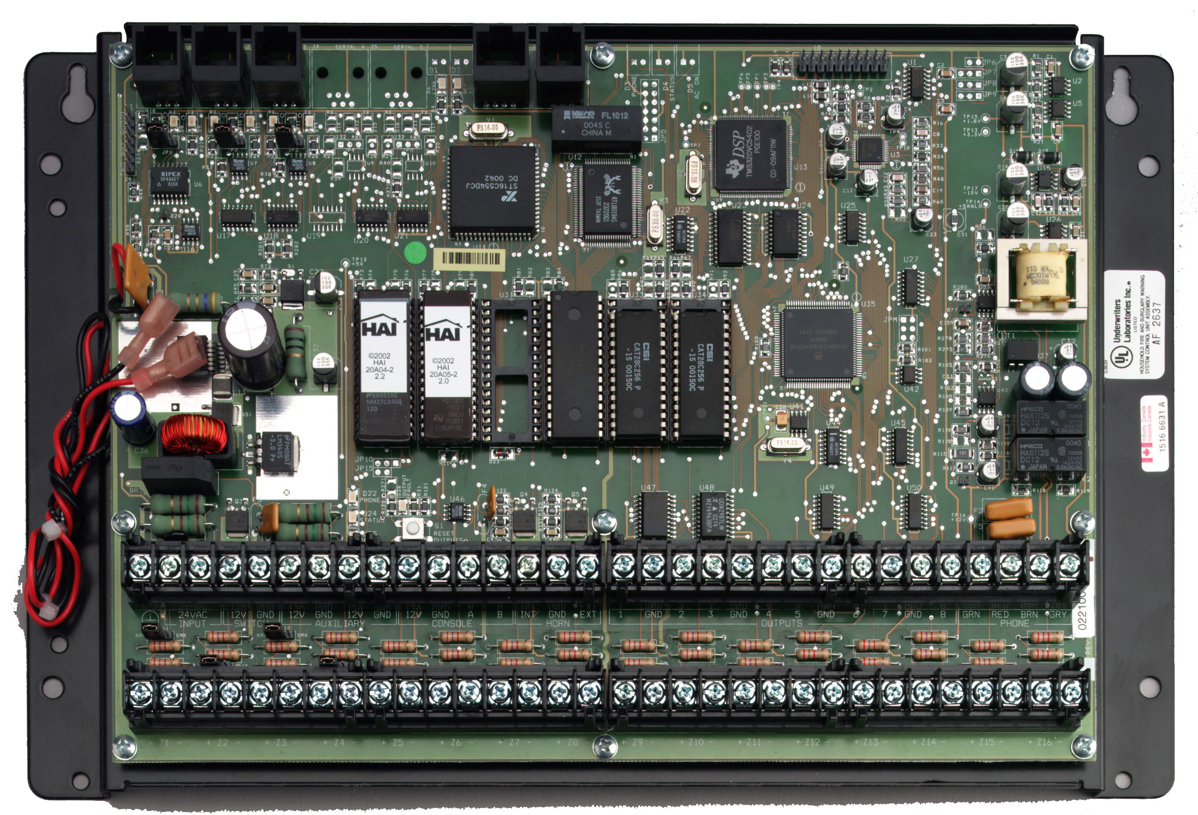

The Leviton OmniPro II is the HAI flagship model. More geared for a large home or a commercial installation.

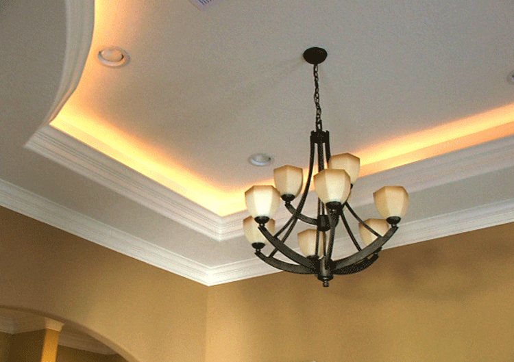

My plan as of now is to use LED strips in the tray ceilings.
Figure out how you are going to install the LV/HV infrastructure for the LED strips in the tray ceilings and wanting them to dim.
IE if 12VDC lighting where will the transformer be? How will you dim them?
One Cocoontech member hired a lighting designer for the placement of the lighting in their home. You might want to consider this.
