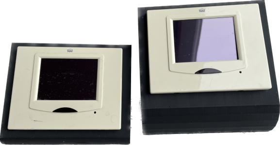

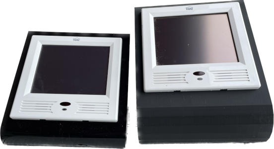

OK so which opening do you need? Also, there is the shorter version, or the one that stands taller, which works best?
@ano made a set of Touchscreen mounts for me. I think the lower ones worked out best. The tall ones work fine as well. They just need a bit of weight in back to make them stable. In the pictures, I have the HAI version next to the one @ano made.
