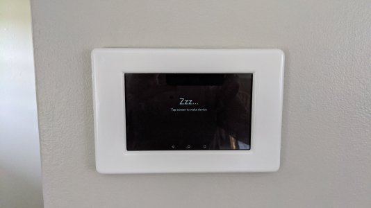

I print these wallmounts for my fire tablets. They have a removable face, held on by magnets, and the tablets snap into it.
Only limited by your imagination.

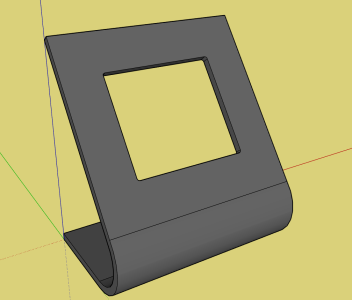

Here is the size / template needed for the cut out.
You have one table mount. Just measure the outer dimensions and cut out dimensions (use a flexible ruler)
There is a web site ( a few out there on internetlandia) called Tinkercad dot com.
You could just take a piece of rectangular black plexiglass 3/8" thick and cut a hole in it on the top. Cut out would be 5 5/8" (142.875 mm) X 5 1/8" (133.35 mm) or what you have measured above and bend the bottom such that that section is longer than the top section.

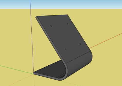

Isn't it just the wallmount screen attached to a tabletop mount?
So it would mount flush like this, no?

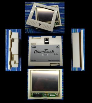

It would need a hole as the touchscreen on top with standoffs and board (s) below. It sits in a protective white plastic shell.
The Omnitouch 5.7 and 5.7e have the same shell.
I have to look at my hot spares here and take a few pictures and post them shortly. The Omnitouch 5.7 and 5.7e are identical in size except that one is serial and the other is Ethernet. Serial one used four wires. RX, TX, Ground and Video. Mine were connected to the HAI touchscreen and video hub. Ideally you would remove the shell and paint it black. HAI used to sell different color covers.
I am still using one Omnitouch 5.7e in wall. It works fine. Base is fine and any modes to it slow it way down. The Omnitouch 5.7 was basic with large graphics that you cannot adjust. The analogue video was better on it than the digital video on the Omnitouch 5.7e.
I have one of these and wonder how hard it would be to 3D print a few.
It would be just taking it apart taking pictures and measurements of the table mount.

So it's basically sandwiched between the tabletop mount?
Like this then?
What's the measurements of the bezel on the front?
Like this then?
Yes.

HAI sold the Omnitouch 5.7/5.7e with different colored front benzels and maybe the above table mount came with a black back shell.
Big picture.
All of the Omnitouch 5.7e / 5.7's that I have have white back shells. I have only white front bezels here.
More than likely you just use a black faceplate and left the white shell (case) in the back. Kind of ugly though. You would just double stick tape the rear of the touchscreen to the mount and the front benzel would snap in to place.
