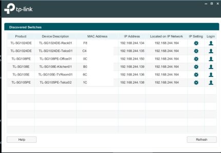

Yes initially here when going to Gb (quit using commercial Cisco switches in the late 1990's) and purchased a tiny TP-Link Easy switch for the Leviton media panel mostly cuz it fit.......in the telco section of the basement...
So have added one TP-Link Jetstream L2/L3 switch and a few Netgear managed switches to my collection here. I do not see the Jetstream with the TP-Link discovery program.
