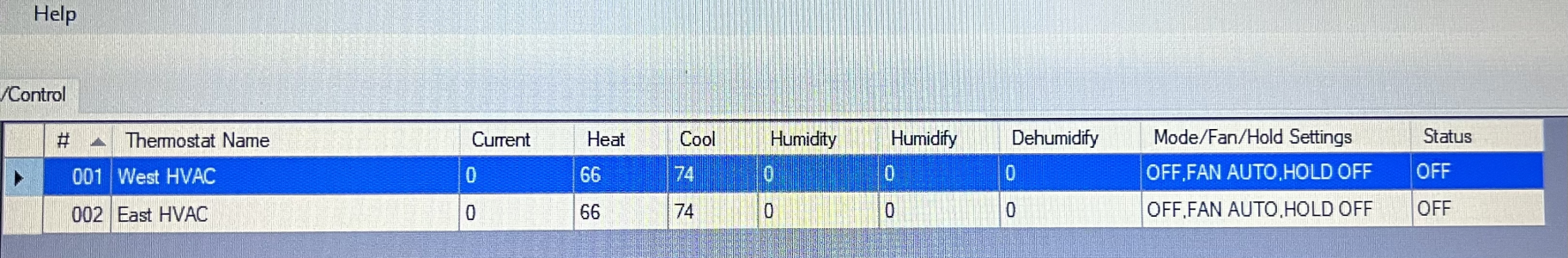

In PCA, I see both of them in the status screen, named as I've named them (see screenshot). When I change settings in PCA, the Snaplink and Pyro apps will update and vice versa so I know they're talking to each other. Just not the stats themselves. tempImageOhyDCH.png
Since the time does not update there is no communication from the Omni to the tstat. Since the current value is "0" there is no communication from the tstat to the omni. I would be surprised if both tstats are broken with the same faults. Can you take a picture of the connections at the Omni? Zone 16 and output 8.. Time to look for broken wires. Have you tried only hooking up one tstat at a time? To eliminate any assumptions... When you change the address in PCA do you also change the address on the tstat?

You change the address for the tstats in PCA. Your screenshot above shows them set at address 1 and 2.
In PCA go to setup - thermostats. The far right column is Protocol Address.
Line 1 shows address 1, Line 2 shows address 2. If you change the tstat address to 3 you need to select line 3 in setup-thermostats. It will then show Omnistat 3 in the right column. You then need to send that update to the Omni so it knows there is a thermostat on address 3. You must keep this set up info in sync with the actual tstat addresses.
