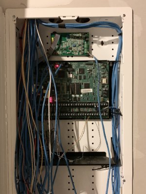

Take a picture of the panel with the wires and post it here.
if I figure out which wire is a temp sensor/motion sensor/etc. what do I do in Dealer Access?
motion sensors, temperature sensors, thermostat are plugged in to zones. Power from motion sensors, temperature sensors come from the 12VDC board. You configure PCA to what zone these devices are plugged in to.
Baby steps here...do one at a time...post a picture...

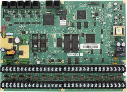

Here is an OmniPro 2 board....last revision note the 5 ports on the top left...to the right is the Ethernet port then the X10 port...
Firmware is upgradable via the Ethernet Port

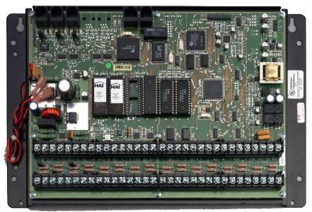

Here is an early version of the OmniPro 2 panel. Firmware is upgradable via upgrade chips.

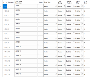

@ano System OK is on the console and the alarm works. This is the screenshot of Zones in PCA. What will change on this screen, just so I'm clear? And
can I use that to determine what is a motion sensor in PCA?
OK, that isn't too good. Try this, do you see the four tabs, Setup, Automation, and the right one says "Status/Control?" Click on that Status/Control, then click on "Zones." That will show if anything is connected. Looks like all your zones are set to Auxilary, which is the default, so nothing will actually trigger your alarm, but click on Status/Control and the Zones and it will show you the actual status. Then open the front door and see if one changes state.

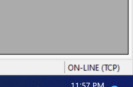

So this tends to indicate that nothing is connected to the panel. They should show up on that screen. Are you sure that PC Access is really connecting to the panel? Are you using a serial connection or network connection? At the top of PC Access there is a tab in the middle that says "Connection". You need to connect to the panel to actually see what is going on. If you know the IP of the panel you can connect via network, otherwise its RS232, which is a pain nowadays, but might be required. So, are you REALLY connected to the panel? You should see "On-Line" if you are connected. Sounds like maybe you aren't.
So it sounds like your PC Access might NOT be connected to the system, so that is our next goal. Do you have any keypads on your system, or are they all Omnitouch 7 screens? Both will work, but the keypad is better. You'll need some information from it to login. A key, IP address, port number, etc. You have the master PIN? I hope.

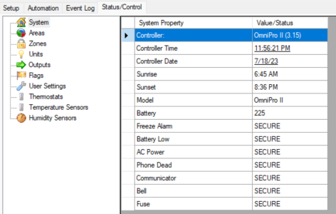

I'm connecting remotely via Network. I'm confident I'm connected to the device. Here are PCA screenshots showing the System Status, and the ONLINE status on the bottom-right of the window.
