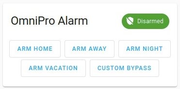

Home Assistant Alarm Keypad display
Here using Home Assistant (and Homeseer) to manage a Ring Alarm (and doorbell and thermostat) for house #2 and OmniPro2 panel in house #1.

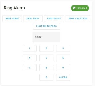

I see an console keypad for the Ring Alarm system but do not see one for the OmniLinkBridge app.
Ring card is defined as:
type: alarm-panel
states:
- arm_home
- arm_away
- arm_night
- arm_vacation
- arm_custom_bypass
entity: alarm_control_panel.ring_alarm
OmniLinkBridge is defined as above.
type: alarm-panel
states:
- arm_home
- arm_away
- arm_night
- arm_vacation
- arm_custom_bypass
entity: alarm_control_panel.in_house
I have added new color themes for the above displays and they do look much nicer.
Anybody doing this configuration for keypad console for the OmniLinkBridge app?

This is the Lovelace template for the Ring Alarm Keypad.
type: alarm-panel
states:
- arm_home
- arm_away
- arm_night
- arm_vacation
- arm_custom_bypass
entity: alarm_control_panel.mokena_alarm
theme: Caule Black Aqua
and the one for the OmniBridgeLink alarm keypad
type: alarm-panel
states:
- arm_home
- arm_away
- arm_night
- arm_vacation
- arm_custom_bypass
Maybe it is just the verbiage alarm_control_panel.in_house
Way back did use two areas then changed it to one area but the "in_house" description remained. This morning changed it back to two areas, removed one area the changed in_house to alarm. Wrote it to the alarm panel using PCA. Looks like a bug in the firmware as in PCA I have the alarm defined for one area although when it reads the firmware it keeps seeing two areas.
Then went to the HA plugin and did a rebuild with new variable names to see if that changes anything. Hopefully it doesn't mess with my automations / scripts that I am using for Amazon Alexa TTS.
alarm_control_panel.in_house remained after my changes and still see no keypad.
Looking at the original ini file and new HA file I do not see where the keycode setting is present to disarm. I read somewhere if the keycode is present then a keypad will not show up unless you utilize the manual alarm configuration.

I don't have any codes defined in my OmniLinkBridge config either but it shouldn't need it as I can arm/disarm when using PCA and it doesn't need a user pin there either.
I'm curious about the comparison between Ring and this one. If the LoveLace cards are the same there must be something different in the entity itself that causes the code screen to show up?
Using the alarmo entity i see a similar lovelace config
type: alarm-panel
states:
- arm_home
- arm_away
entity: alarm_control_panel.whole_house_2
and if I flip-flip between the alarmo entity and the hai entity the pin pad disappears. I'm not sure how to dig into the entity itself but thats the next step.
