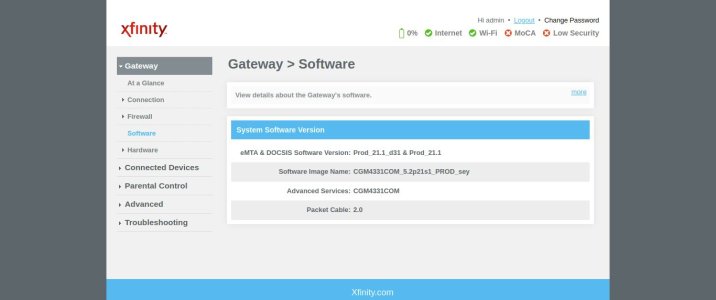

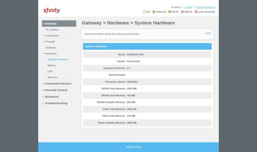

Connecting again for you to see their Hardware and firmware revisions which are probably different than yours.
